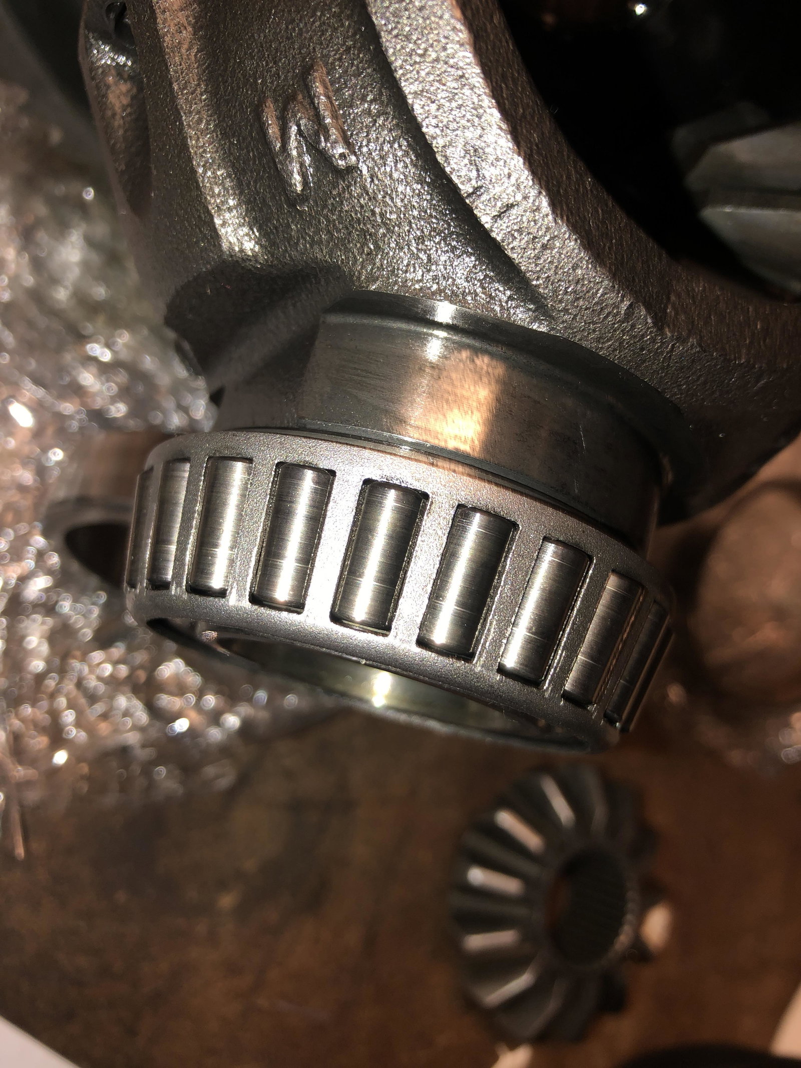

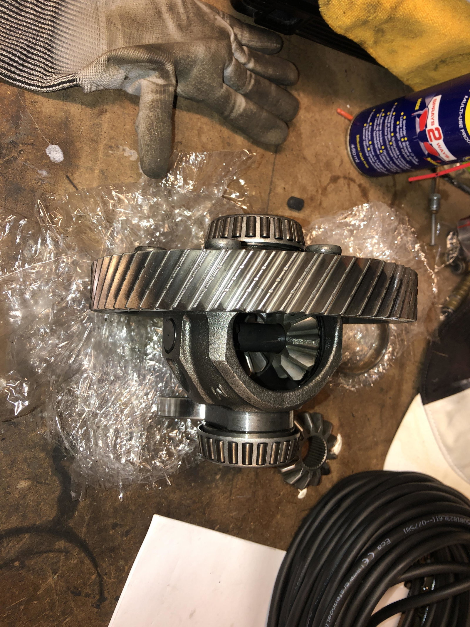

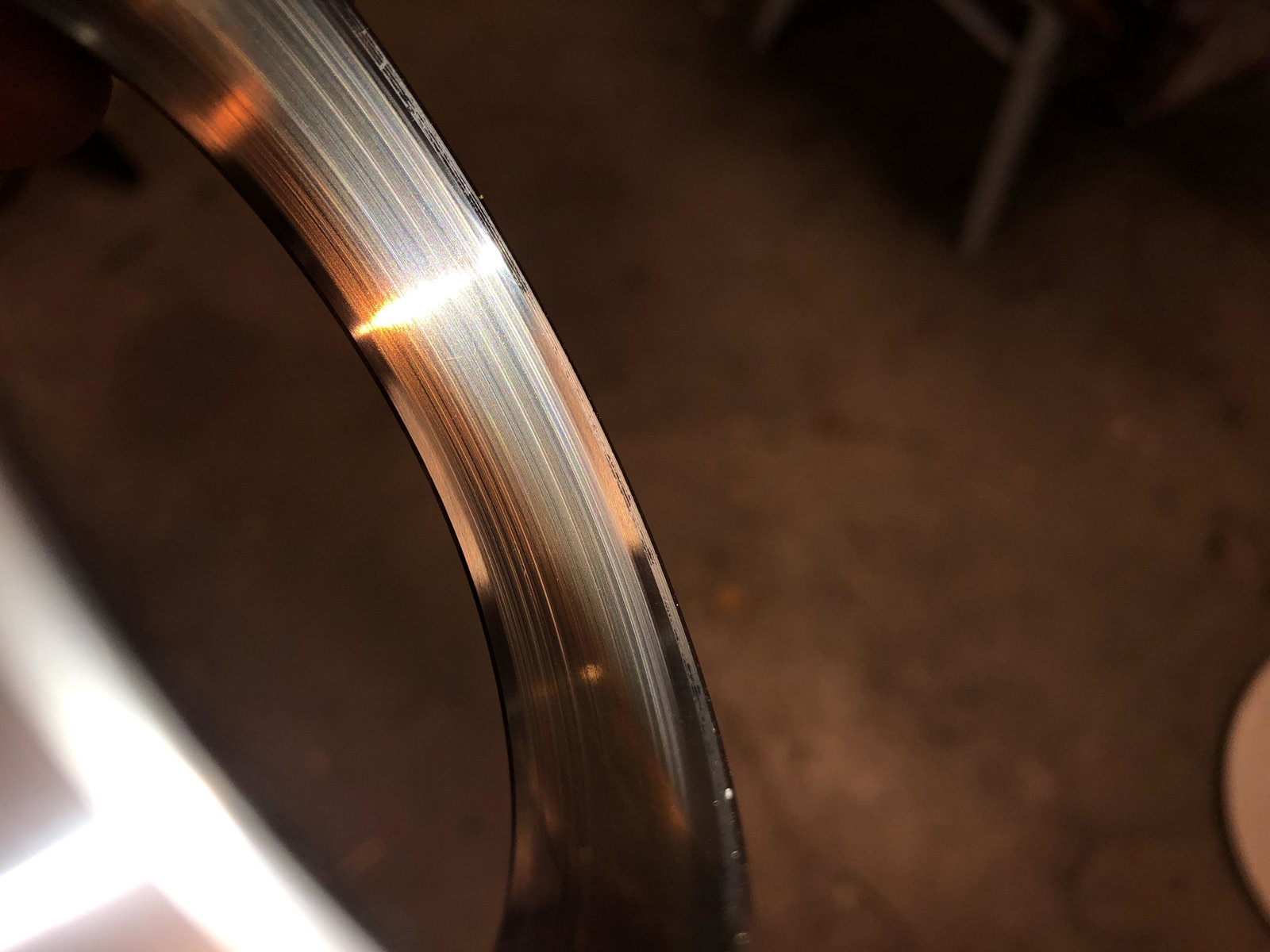

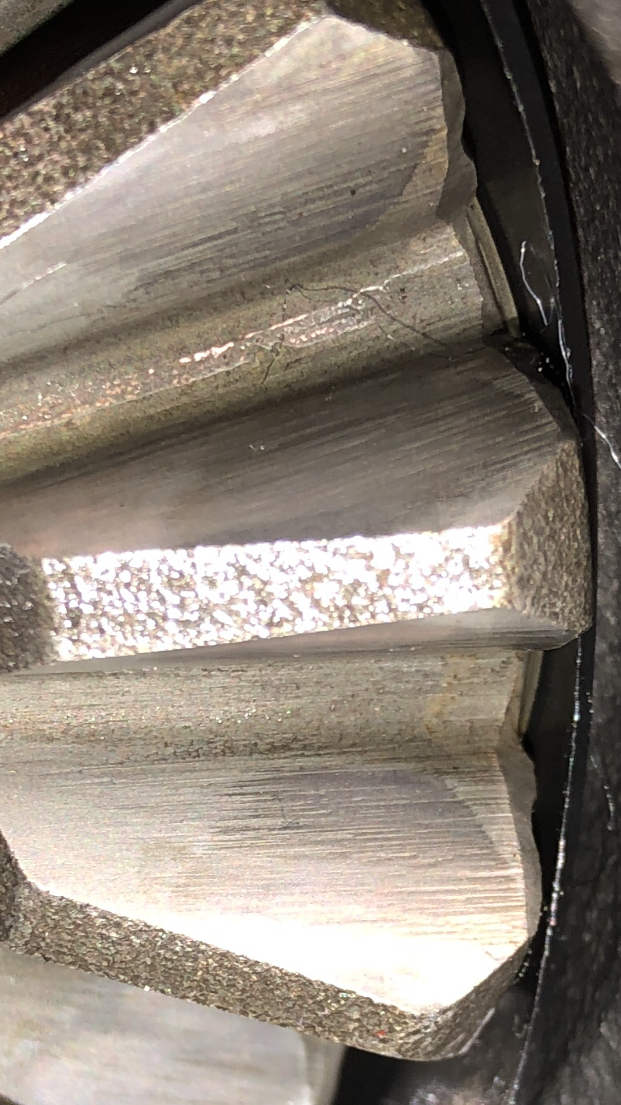

hi again,
Differential and it’s bearings replaced, noise is GONE. Jihuu, finally. Bearings have clear scrathes and pinion gears have quite strange markings… these could be bad machining or someting more severe… clear quality issue. From where did the particles come from, remains open question. Few pictures from damages attached.
