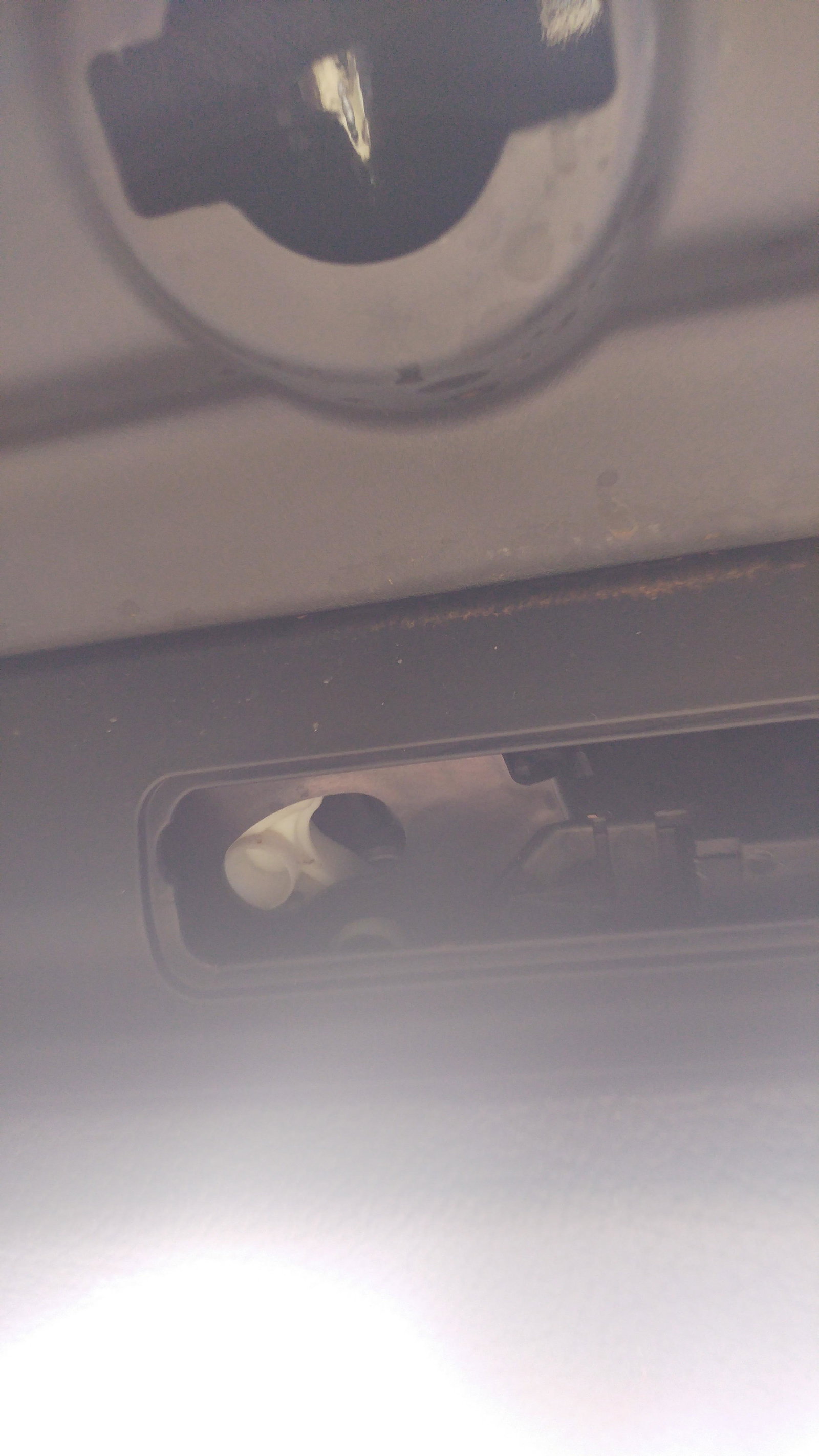

Put the back seats down and try this way to put the battery back
All back up and running, will take it to local garage later to have battery checked , pic below shows the boot release button its located where the emergency triangle is kept, there is a 2" piece of plastic which pops out using a flat edge screw driver and its the white catch you need to slide across

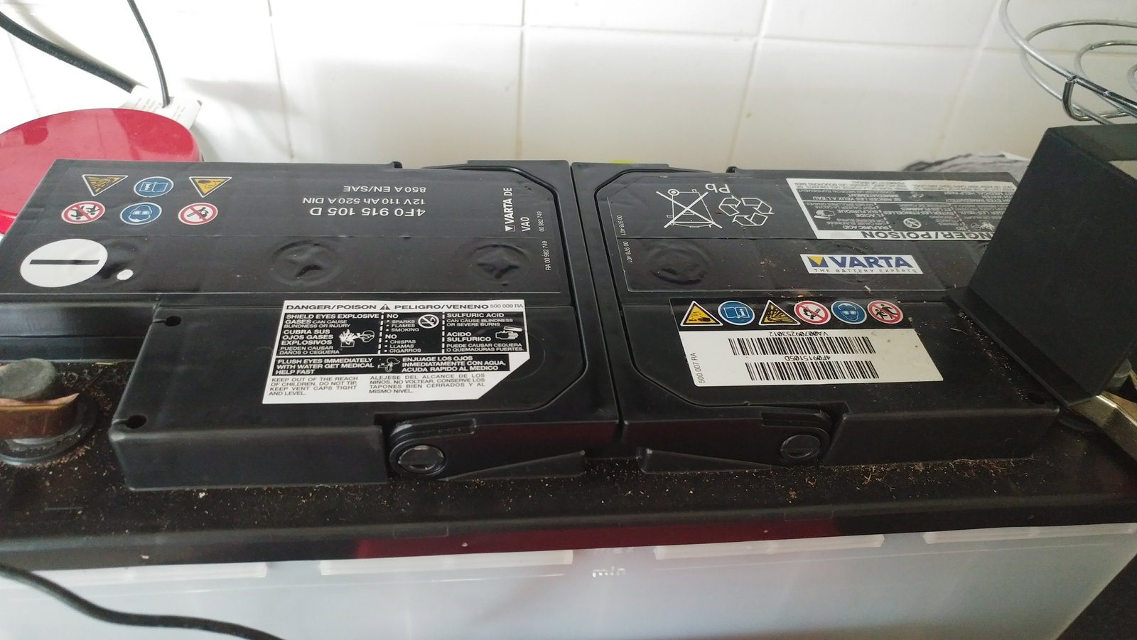

Hello Paul,
Varta battery is likely to indicate it is the original, and I'm with Steve on this that the battery has done its time. If so, and it needs renewing, I have used Battery Warehouse (I think) at Tewkesbury. They do good mail order deals and seem nice people to deal with- no connection and no doubt there are others.

@Magnet cheers good prices on that site http://www.batterymegastore.co.uk/batteriesfinder/index/productlist/
Update: Battery is fine, next step is to see if it happens again then back to garage and hook up to computer to see if any fault codes are given.

Hello Paul,
As Steve says- fingers crossed. iF it turns out that there is a problem then If it were mine, I would be spending half an hour's time with a good auto electrician who can check whether there is any parasitic drain on the battery for you - rather than spending probably more money on plugging it into a computer.
You've had nine years out of the battery (if original)  , and long may it continue to be trouble free, but it could be worth bearing in mind that   when it does need changing that it may be worth sticking to a battery with a minimum of 4 years guarantee, and these can often be bought just as economically as your average 3 year one if you shop around.

@Magnet Battery was hooked up to a hand held machine which ran a test with engine on and off and with head lights on and off, was also connected to points in the engine bay
Hello Paul,
Battery test sounds like a voltmeter testing the alternator output voltage and the voltage at the battery with lights on etc. Ok, but..... the ultimate tests are if the battery is able to retain the charge which is put into it, and be able to efficiently produce the high current demand placed in it when starting  -while maintaining an acceptable voltage.
Halfords normally carry out battery testing and are able to give you a % efficiency reading which will firmly point you to whether the battery is as serviceable as it should be. If you do eventually have it tested and if it does need replacing, you can then decide where you will get one from.
As you say, you don't want to buy a new battery, and I wouldn't too, so let's hope it all works out in the end.

Spot on . No way a 10 year old battery will be ok .
In case it helps Paul, and his wallet, I think I might dilute the statement that "no way a 10 year old battery will be OK".  If it's an  aftermarket battery then I would most certainly agree, but if it's the original battery then it's certainly worth having it checked for serviceabiliy rather than assuming it's unserviceable.
